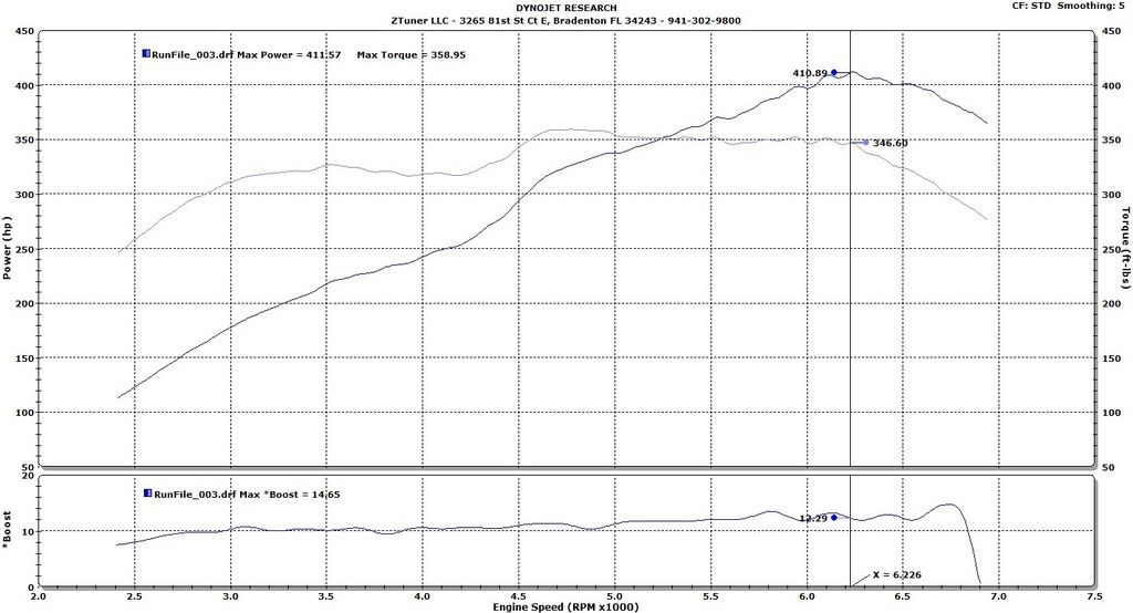

we were having boost controller issues and honestly were not really interested in tweaking the pump gas numbers to the limit. This was a "what if E85 isn't available, safe 93 tune" As stated before torque had to be reduced quick and dirty by running less timing in the midrange. could be smoothed out but was not on our agenda.
